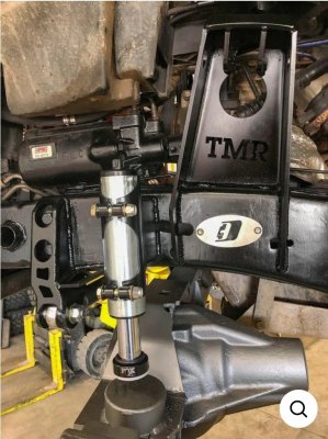

This is from TMR customs. I like the look and probably end up with these for frame mounts.
Maybe the week give folks an idea of what I'm talking about.
