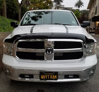

All depends on what you're changing grill to if the delete is really needed!
Quite a while back I bought honeycomb grill inserts and removed all but the upper and lower slats in the AGS to accommodate behind the grill LED pods. I had to swap inserts due to Bighorn chrome grill openings too narrow to allow light through.
Stock everything in cooling system, stat and clutch fan, and temps dropped by 10-12 much needed degrees cruising on freeway which is when AGS is active.
I also bought the delete kit but never used it!
From what I understand the delete kit is simple(looks like it), but ???
My light pods are visible behind the grill but Im ok with it...lol
