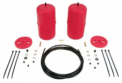

You need some bags in the rear to help with towing your trailer. You can go with helper bags that go into your drop springs or you can replace your springs all together with a pair of actual air bags. Here are links for both products.
You can use shorter helper bags for an 18 Dodge Durango because of your lowered springs.
https://www.amazon.com/Air-Lift-60824-1000/dp/B0050Z1SJC
Here are the air bag kits, I would contact them to see what would be the best for you.
https://timbergroveenterprises.com/0917-ram-1500-crm
