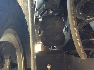

I am in the same boat you are in. Although I have a 14 PW with coils but same situation. I opted for he timbren helper springs instead of air bags. Not only are they a little cheaper but I was worried the in mountains I would tear an air bag or an air line (which I read happens on the PW's because of their flex). The timbren look like a big bump stop but are hollow and allow compression. I installed them this past weekend in about 30min. I have only put about 500lbs in the bed so far but before they dropped 2" and after it stopped at the 1" when hitting the timbren. This weekend I will be on a bear hunt and will have a 4wheeler and plenty of camping stuff in the bed. I will let you know how it does. I can tell you that unloaded there is no change in ride at all.

Looks like this after install. Again it's a 14 so I have coils not leaf springs.

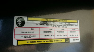

So do you know what the payload rating is for a power wagon. Very frustrating when you explicitly tell not only the salesman but the service manager what you plan for the truck and they do not know there own products
myoung84
Dec 2, 2010
1,899
321
Tulsa, OK
2012 Power Wagon
Should be on a sticker in the door jamb. Here's mine from my 1500 (1272 lbs).
Sent from my Samsung Galaxy Note 3.
GirlPower
GirlPower
Feb 18, 2014
30
11
2013 Power Wagon
Perfect thank you
