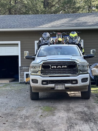

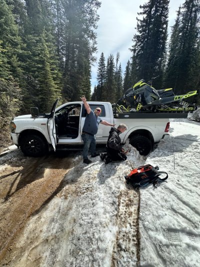

Ram 2500 6.4l with factory air in the back. No issues with my Marlon 7’ deck and 2 Sled’s on the deck. Way better than the 2 place trailer I used to use. Now I have better traction in the mountains with the weight over the rear axle. Another bonus is we can get into tight areas you would never dream of with a trailer.
Just added a sxs rack to my deck so I can pull my 30’ TT this summer. It’s mostly fine except for the dished sections of highway and the side to side rock can make my butt pucker at 65mph. I’m going to add outboard airbags and daystar cradles to help tame it.
