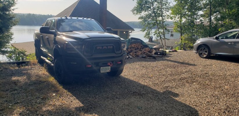

As mentioned I didn't notice anything tippy with a deck and 2 long track sleds on my buddies stock 18 PW...we take long trips to the Canadian border and split the driving, so I've had a ****load of wheel time...I wasn't railing corners or driving like an idiot but zero issues..Felt just fine to me. Its also very likely most of your driving might be without the deck or all loaded up and you'll have that sweet PW ride for the vast majority of your driving.. Try it stock, you can always add on to dial it if you need to..Best truck I've ever had

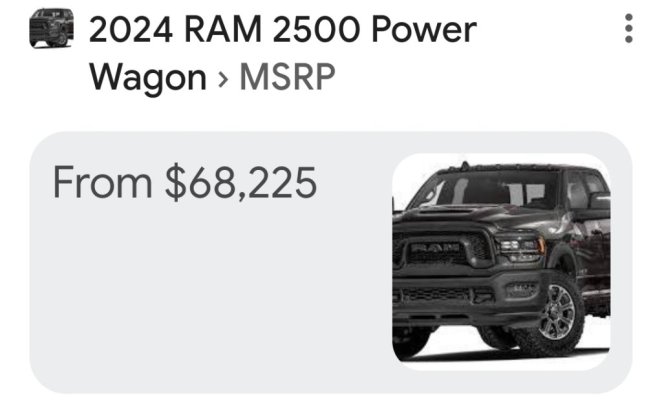

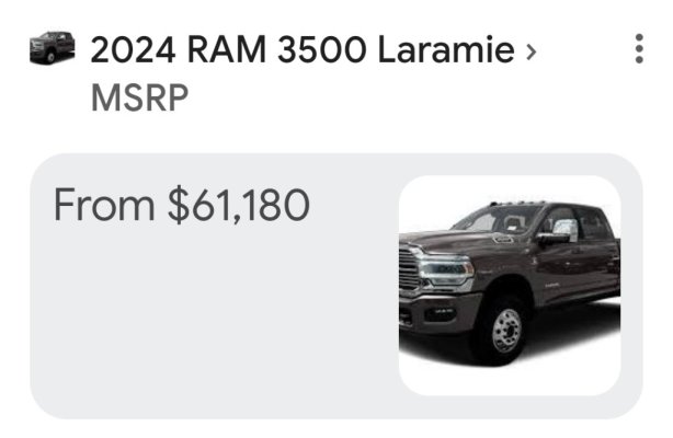

And let's not forget a Laramie 3500 is over $7k msrp cheaper too. That's ALOT of mod money, IF it is even necessary.
According to the Ram.com website, the 3500 Laramie posted above is for a 2wd version. If you want 4wd it starts at $74k.
https://www.ramtrucks.com/bmo.ram_3...Page=ram_3500&year=2024#/models/2024/ram_3500
You do have a valid point, but sounds like you would need to start with a Bighorn model if you wanted to start with a cheaper truck.
