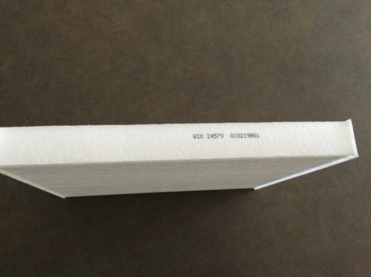

Here’s a cabin filter I have with 3 brands stamp. Wix Hastings AFC

I’ve found that some brands air filters are made in the same factory as cheap, identical knock offs. Find those knockoffs. I’ve never had any issue with cheap air filters changed every second oil change.
