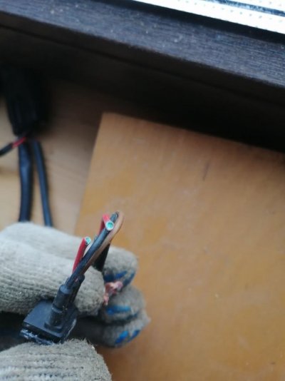

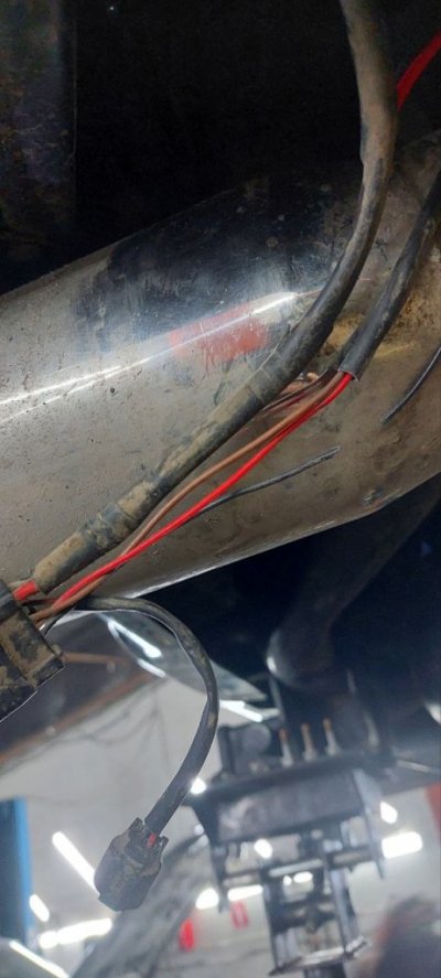

Horrible set up, my two main wires broke right at the entrance to the compressor...the whole thing need to be replaced...guess who's scrapping their air suspension.:)

So, the wires just can't be fixed? Id be trying to fix the wires before I spent all that money and time deleting the air suspension but thats just me.
The wires go right into the compressor motor. Opened up, zero room to add wire. Plus, the covered wire from the plug right to the motor, pitch black. Would love to know how plastic sealed copper wires turn black with moisture. I tried, but no luck to fix it.
7livzz
Jul 11, 2017
Check wires that comes from compressor. They might be broken inside.
