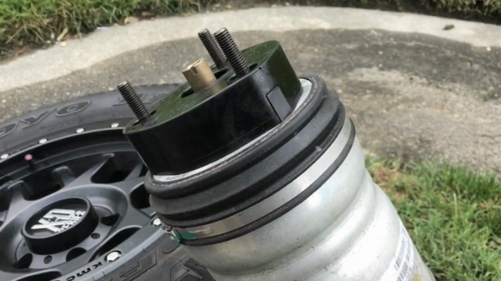

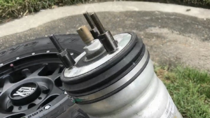

Yes BDS and AEV for 4th gens. Nothing released yet for 5th gen.
Someone with BDS had a failure which may be from corrosion at the air line connection at the top of the front strut. The BDS use a a spacer which encapsulates the top of the strut and potentially traps mud and debris. This in the Rebel Owners Facebook page just today.
This is the daystar spacer sitting on top of the strut. Since the bds spacer is taller, it probably surrounds the fitting completely and create a cup around the fitting with no way for mud or debris to drain out.
