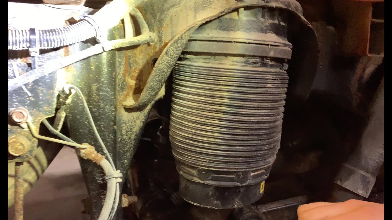

So, I was browsing Facebook marketplace and I keep seeing front air struts that guys have removed from their trucks to switch over to the standard strut. How hard would it be to add a line to either a remote schrader valve or plumb it into a small tank that you could adjust the pressure on. It's just a thought, I've never seen one of these struts in person, so I don't know what kind of fittings they use. I also don't know what kind of air pressure those struts normally run at, but would be something neat to mess around with if it wouldn't be too hard to plumb some lines in.

I briefly had mine switched over to run on an Accuair setup. They run relatively low pressures 150psi max. Mine sat around 60psi in the struts for a factory ride height. The plastic top hat on both struts and the rear bags were easily tapped for a conventional air fitting and plumbed with plastic line. You could easily just elim the factory solenoid and compressor, but then it's all on you to remember to maintain pressure and adjust as it leaks and load changes.

Yeah I wasn't trying to run the full air ride system, just wondering if it'd be possible to plumb the OEM air shocks to a standard type of air line and run it on compresses air.

What would be so hard about it, the air struts are bolt in. The question was if you could plumb the air lines up to normal air lines. Zero intention on trying to retrofit the entire system, was only interested in if it was feasible to install and plumb the OEM air struts up to something other than factory stuff, which has been confirmed as being possible. If I wanted to add air suspension to the rear, I'd look at the new system from logiq.
