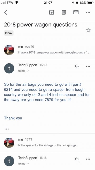

This is the email back from hellwig tech support. Keep in mind this is for a stock power wagon without a lift. Hence why they told me I need different spacers.
Sent from an undisclosed location in Iraq
Hmm, I’m not sure what they are talking about. :hmm:

Those are the hellwig part numbers for their airbag and rear sway bar.
