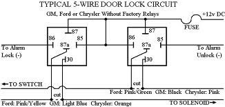

ok i bought a cheap ass alarm which was my first mistake. i honestly dont even care if the alarm part works all i bought it for was keyless entry. got most of it all wired up and im hung up on 2 things. first i cant seem to get my parking lights to flash. i pulled up multiple wiring diagrams and they all said to run the wire to the purple/yellow wire. some said to do it with a resistor. tried both and the only thing i could get were my dash lights to flash. i tried every wire at the headlight switch and still got nothing. second is the whole reason i bought the damn thing. cant get the locks to work. its a negative switching alarm so it should work. my problem is i cant seem to track down the right wires to do this on. any help would be greatly appreciated since im borderline about to scrap it or pay someone more money i dont have to do it.

Positive wire for the parking lights is a black/yellow in the drivers kick panel. For the locks its a 5 wire setup which is kind of difficult if you are new at wiring and alarms but here is a pic I found on google. ImageUploadedByTapatalk1338735159.568057.jpg

k new problem. got a new alarm and everything works except unlock.my friend says i dont need any relays and im trying to wire it up the way the wire chart says. the lock function is working perfect. problem is i cant get unlock to work at all and if i try to piggyback lock/unlock the lock function doesnt work. ive tried the 330 ohm resistor and no resistor. can anyone help?
