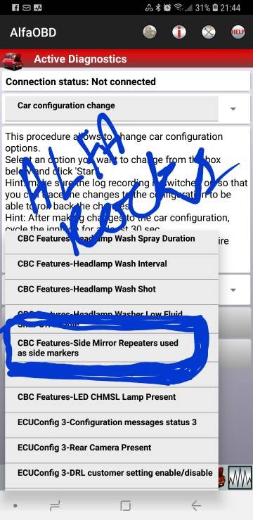

Sent from my SM-N950U using Tapatalk
I believe we came to the conclusion that those are for the marker lights on the rear fenders on a 3500+ Dually. No reports of anyone with one trying it yet. It doesn't do anything on a 1500 or 2500.
