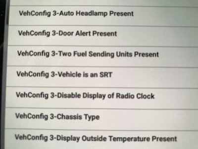

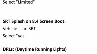

Hey guys I set my radio screen a couple months ago to say SRT on start up. I’m taking my truck to the dealer for the recalls and wanted to return that feature back to stock. Can someone tell me which is the correct section to put that back to stock?
Is this the correct one?
To set it back, just select no on the "Vehicle is an SRT". If you have changed nothing in your "Special Packages" locations, then I'm pretty sure it will revert back to normal. The SRT splash setting can take a couple rest/ignition cycles to go away.
Edit: If for whatever reason it does not return, you can also look at your original BCM configuration and look for "Special Packages". Write down which each one is set for and then go into Alfa to change to original. Definitely set to "No" on Vehicle is an SRT though first then see.

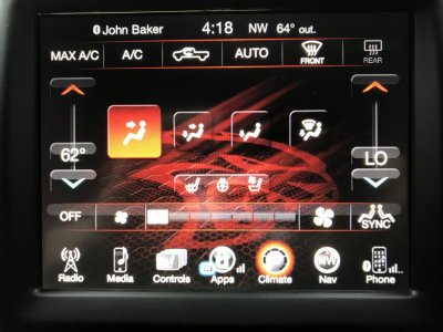

Thanks for the help, I reset it and let it rest 20min. The splash stayed and so did the background. I went to the display and all options to select were Ram now so I chose one and now the background is back to normal. I’ll let it rest overnight and see if the splash goes away.
This is one of the settings that does take a bit to reset. Hopefully it’ll be back to normal by the morning for you. This one took several hours for mine.

Thanks, I just went out and checked it again and the SRT was gone and back to RAM. It took about an hour. The screen looks really boring now. After my dealer visit I’m going to set it back to SRT. I really like this alfaobd
