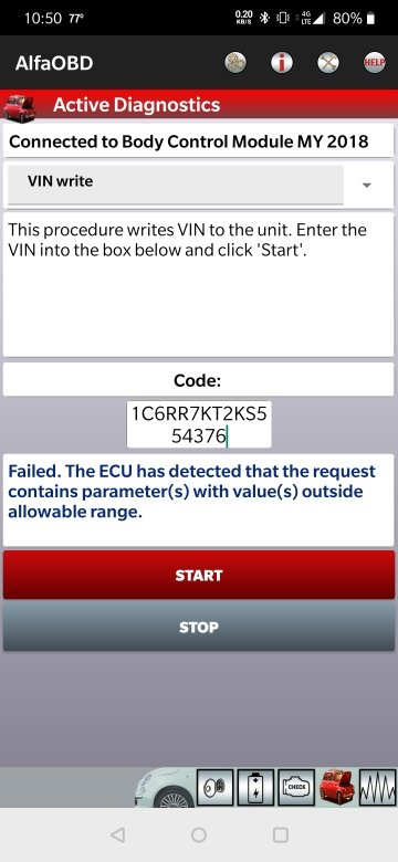

Sent from my GM1915 using Tapatalk
jdomke1
Apr 8, 2016
66
23
Manteca, CA
No idea. I know my model year wanted 17 digits. No idea if 2018 is the same. I was also doing mine through the instrument cluster not body control.

I’m not sure why there’s a need to write the VIN to the cluster. My swapped in cluster just picked up my VIN automatically. When I read the cluster system ID, it shows my truck’s VIN as being the current and original.
Kenepo17ram
Oct 28, 2019
144
35
Brooksville, FL
Your correct i ck system id and reads my vin, year model of truck
