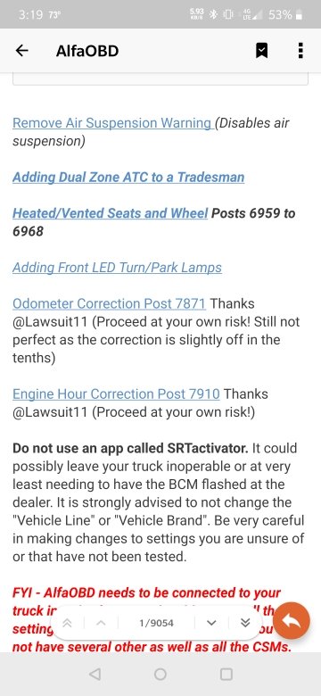

I just got the alfaOdb app this past week. I tried to back up the file as stated in the OP, but got a “no data” message. I tried a day later and saw the file I’m supposed to backup and uploaded it to google drive. I opened up the file and it’s empty, no data inside. Am I doing something wrong? I did have the battery disconnected before trying because I had to replace it. It doesn’t seem like that should effect the file, but since I’m a noob with this I want to make sure. I do want to make sure I have a good backup before making any adjustments.

Hit the battery icon. It will force feed a BCM read & then you can upload the backup your GD.

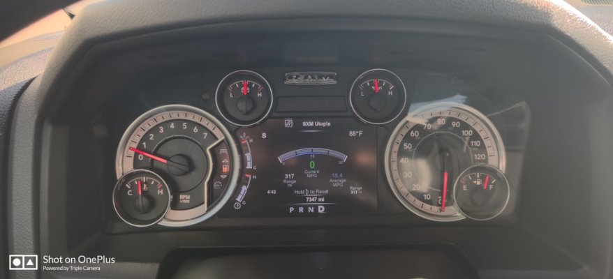

Is alphODB all thats needed to when upgrading from the 3.5" EVIC to the 7" one or is there more programing that has to be done?
