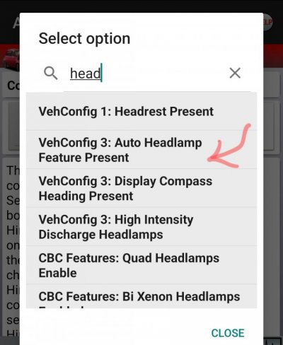

I have a similar problem. Somewhere along the line (Using the AlphaOBD) I inadvertently disabled the "Auto Headlights" on my 2015 Ram 2500 so that when the headlight switch is in the "Auto" position, it behaves as "OFF" and I must manually turn my headlights on and off. Any idea on how I can correct the problem with my AlphaOBD?
Mpgrimm2
Mar 30, 2014
6,096
4,175
2022 Ram 1500 (5th Gen)
Maybe this one?....
