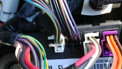

It depends on the mirrors you have now. You can look at the white plug inside the door panel. If it has more than 4 wires, then you have the capability already. Are your mirrors the chrome capped?
I just pulled my door panel. I have the power, power fold, heated mirrors but looks like only 4 wires on the white connector (the wires coming in from the top of the pic) . About 9 others from the mirror on the black connector.
