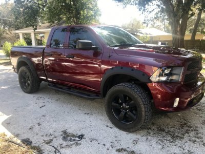

Just curious, got any pics with the lift and factory size tires?
