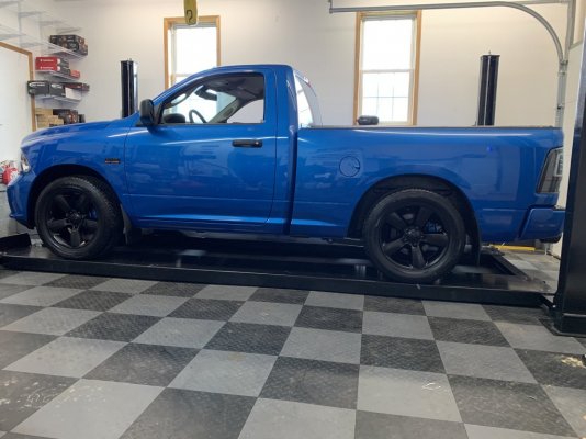

For those of you with 2\4" drops, are you having the truck realigned to "factory specs" or something else ? IMG_5481[1].JPG
