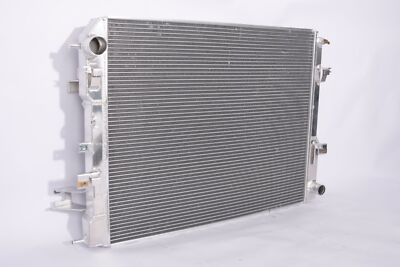

4 core rad 2.44” thickness - $279
Stumbled across this 4 core for the 5.7 that actually has a thicker core dimension. They probably have one for the 6.4 as well
Seems like the stock radiator core is <=1.25” thick, single core.
I’m curious of fitment; there’s only ~1/4” of room on the front side before the mounting posts at the end tanks. I have 1.5” space rearward before my v6 fan would hit my mechanical (can’t use v6 alone, locked pcm).
Plenty of space for the core width as it’s much thinner than the end tanks.
