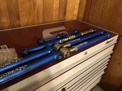

You might want to look into a set of Inez's relocation brackets.They help bring the rear suspension back into spec,and move the instant center back under the truck,instead of having it pointing into the ground just in front of the rear tires.They'll help plant the rear tires better on launch.Go right for the cut versions of Inez's brackets if you do,don't even mess around with the no cut versions. I'm running the earlier Illicit brackets on my truck,and the truck will cut high 1.50 60fts pretty easily,plus it'll hook on a skating rink,lol.You can see them in these photo's.
Do you know if I could still use the core 4x4 ladder bars with these relocation brackets? Thanks for sharing this
Supposedly they work in conjunction with the Inez brackets,but i've never actually tried them myself.I ran Cutter-ups heavy duty double adjustable locating arms with my Illicit brackets with no issues,then i went on a light weight kick and sold the heavy duty Cutter-up arms and put the stock locating arms back on. When i initially lowered my truck,i had killer wheel hop,but the Illicit brackets totally cured that issue,so i didn't need the heavy duty aftermarket relocating arms. My truck never did have the high speed sway issues that alot of the shortbox regular cabs have after lowering,but i had wheelhop issues bad enough i was scared i was going to break an axle. I did spend a bunch of time making sure the relocation brackets were lined up as close to perfect as i could get them,then i ran a couple tack welds so they couldn't shift around on the bolts,and to also minimize bolt maintence .I check the bolts every spring,but with the brackets tacked in place,i've never had a bolt back off yet,and that's 5 years of dragstrip abuse and 40,000 miles of street driving

Not sure if the crew cabs are different from single cabs but I have the Inez cut brackets on my truck with the core arms and they worked fine. Only part that spencer had to adjust for my kit was the stabilizer links.

They don't move the arms down far enough to make a big differance in where the instant center ends up under the truck. Plus alot of guys claim to have issues with the no cut versions,and end up eventually switching to the cut versions.Ideally you want the imaginary instant center lines to intersect at least as far forward as the transmission or slightly farther. The instant center lines are imaginary lines drawn down the length of the locating arms,and where those lines intersect is called the instant center,and that's roughly about the point the leverage off the locating arms tries to pick the truck up. The farther ahead those lines intersect the more leverage and weight is applied to the rear tires,forcing the rear tires into the pavement harder. Actually it's not good for a truck to squat on launch,when a suspension squats it's actually pulling the rear tires off the ground,ideally you want the chassis and tires to seperate ,as then the truck is pushing the tires into the ground.Physics comes into play,and the easiest way i know how to describe it,is if you try to pick up say 50 lbs by your arms,you also add 50lbs to the weight on your feet,now take that weight and put it on a rope and pulley set-up over your head,then try to lift that weight off the ground by pulling down on the rope,the weight on your feet decreases.That's the same basic laymens principle behind why you don't want your truck to squat hard on launch,as basic physics law states for every action there's an equal and opposite reaction,which means if the rear bumper is going down,the rear tires are also lifting up.You also want the lower locating arm as close to parrellel with the frame rail as you can get it,as it's the lower bar that does the majority of pushing on the frame,and ideally you want the bar and frame in line when the pinion angle rotates up on launch.Not only that if the trucks squatting it's wasting energy/horsepower by collasping the rear springs.Alot of guys don't realize when a truck squats,it's wasting horsepower trying to collasp the rear springs,that's wasted power that could be applied to the frame rails instead,which will put more horsepower towards actually pushing the frame rails straight ahead,instead of down towards the ground If you try to push on something with say a broom handle,it's always easier to push that object if the broom handle is directly in line with the object you're trying to push,then it is if the object is offset and on an angle from the broom stick.Not sure if that makes any sense,but it's the easiest way i know to sorta give you a laymens idea of how a rear 4 link suspension works
