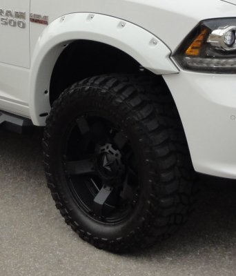

I've got Cooper STT Pro's 35x12.5x20 on my Ram & love them.
Price is competitive & they're very quiet for a M/T tire.
They weigh in at 68lbs....about 12lbs less than the same same Toyo M/T.
