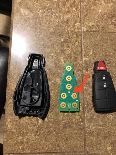

I assume you mean the remote...
Take it apart and see if it looks like this:
The important section for you is round pad underneath where the new remote start overlay will go (red arrow in pic above).

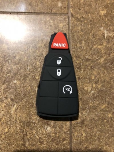

New overlay:
The extra button pads on the circuit board are used in other applications for vehicles like power liftgate on SUVs and charging up the flux capacitor (just kidding - that’s only for a DeLorean).
New overlay:
Ahh gotcha, the overlays i got didn't have the metal underneath the rubber
You've answered all my questions!! Thanks so much!!
