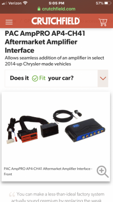

How did you install this? Ive literally been looking for weeks. I know how to install a basic sub/amp system but I have no idea where to wire things to. Or what a PAC even is. Also heard I need an LOC? Sound shops want over a grand to put a better subwoofer and amp in my 16 Rebel because of the alpine system. Thanks for the help.
TomT
Jul 1, 2015
1,281
565
SoCal/OC
The post above yours shows you exactly what you need. The PAC unit also functions as a LOC. Just connect amps or DSP from there. Check YouTube for install videos.

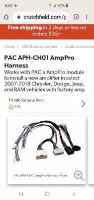

Hey thank you for the reply. I went to buy it and it's saying I need this too? I watched a video and this wasn't part of it. Have you seen this before?
TomT
Jul 1, 2015
1,281
565
SoCal/OC
Not sure, I had my shop take care of it.
