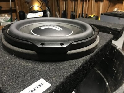

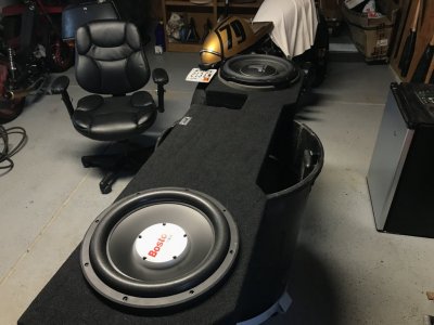

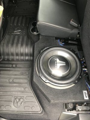

JL Audio 12TW3 and Boston GTR passive radiator powered by a Rockford R500x1D. Pretty tedious to shoehorn them into the eBay box, 10s are ideal with the airspace available to keep your rear seats.
