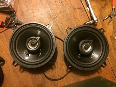

Sounds great and very loud Had a bit of a drone to it so I put sound deadening material inside on the walls. Dynomat like stuff. Its going to need rubber feet also. It actually slides along the table when its cranked up lol.

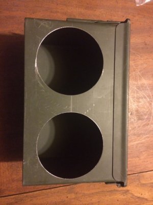

That's a neat use of an ammo can.
How'd you cut such clean circles?

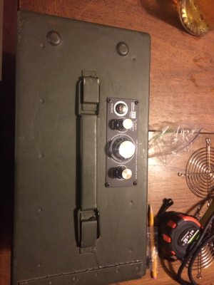

I have a few of those boxes floating around. Hmmm it'd be cool for my atv or just all around boombox.
How'd you power it? And where'd you get that neat little knob panel thing?

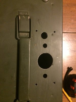

Never mind about the panel. I see that you just unscrewed it and remounted it with the box in between the amp and the panel. Good idea.

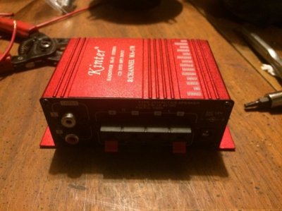

I have a 12V power supply from something, not sure what fro honestly. Maybe an old drill charger? The panel is something I custom mounted. I took the amp apart and mounted the amp from behind. I put the panel on from the front and screwed it all back together. Here are some ebay links to help you out.
Amp
MA 170 Kinter Hi Fi Mini 2 Channel Car Amplifier 15W 15W Stereo Auto Amp DC 12V | eBay
Speakers (the ones used. You can use anything you want)
New Pair Planet Audio TQ522 5 25" 2 Way 4 Ohm Car Audio Speakers 160W 636210102601 | eBay
Power supply
New 12V 2A Power Supply for 3528 5050 LED Strip AC 100 240V Converter Adapterc | eBay

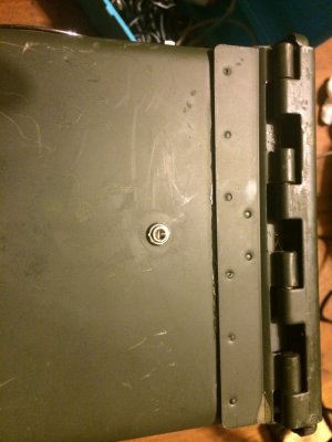

I also installed a 3.5mm plug on the side as well as a power supply plug so no wires are hanging out of it on a regular basis. Im also working on a rechargeable battery pack for portability. Here are the links to the audio and power plug
5pcs 1 8" 3 5mm Female Phono Mono Panel Phone Jack Screw | eBay
10 Pcs 5 5mm x 2 1mm DC Female Socket Panel Mounting Power Chargers Nut | eBay
To do this job you have to know how to solder, have some audio knowledge in terms of how to set everything up, you will need a 4.5" hole saw for the speaker cut out also.
