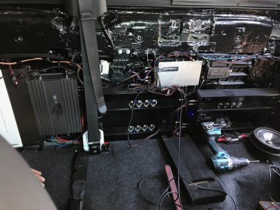

Ok guys, show me where you mounted your amps and how you did it please and thank you!

4B446422-B438-444B-BC13-9D9B14390585.jpeg Construction adhesive, sheet of wood, screw the amps to the wood.

81A59D13-8F65-4F15-B034-7CDDB60A6401.jpeg E6C020D9-236A-4CF8-92E5-6690BC985BC6.jpeg I’ve actually gone back to this amp configuration.

Much cleaner

Like Tom did, I would make a simple amp rack from wood and attach amps to the rack
yea but what are you using to hold the wood to the back of the wall like that... tried Loctite and it failed
I used construction adhesive and stuck it to the dynamat that I had on the back wall already. I could pull it off, but it would take some effort.

I used the Loctite adhesive and the bump from the subs knocked it right off... I even tried to pull it off by hand and it wouldn't come off... sigh. I'm going to try gorilla glue
