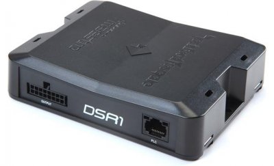

Some of the people here have been using this, Rockford Fosgate DSR1

I am not trying to replace the factory amp as it will still power the rear speakers. Not sure if these keep the factory amp active or not. If so, I could go the RF route as it's the same cost as the AmpPro but with a ton more features. Just need a way to capture the full range signal for the front but keep the fade adjustment to easily raise the level of the rear speakers when i have passengers. I already have a 7 band EQ I have in my center console too. Time alignment would be nice though and allow me to go active later if I decide too

Cound not agree more. And i would definitely go the DSR1 route if I have the ability to retain the factory amp and just use it for the added amps and speakers. Even though they will be turned off to help with front stage, still would like the ability to turn them up when passengers are riding. I've emailed crutchfield to see if they know the answer.

Did some more research and it looks like all are factory amp bypass units. So I went ahead and picked up a cheap set of 6.5 components for the rear, adaptor plates, and a small amp to power them. I'm assuming the DSR1 is better than AmpPro based on the additional features. Am I correct in this?

There were initial issues with the DSR-1 software but they’ve steadily been making improvements. I went with the PAC and a Mosconi DSP to get a more powerful processing system.
I guess I’ve never really been a fan of All-In-One units but they do offer a solution at a lower entry cost. I just like having the ability to swap out individual pieces if I want/need to.

Oh I know that lol. But regardless of what they know or don’t know, both the dsr1 and pac units utilize the factory amp plug on the radio, thus making it disabled. Not a huge deal as I have already ordered a small amp for the rears (possibly enough for my tweeters if I go active later too) and a set of components. Nothing fancy as they are just there for rear passengers when I have them. Still think the PAC unit is the what I’m going to do for now. I’ll look at dsps down the road if I feel the need.

I'm considering picking up a 6 channel dsp and only feeding it the front 2 channels off the Dsr1 and still running the rear speakers and subwoofer off the Dsr1 and the front as a 3 way set up off the second Dsp. Anybody try this or see any problems with it. Thinking just tune the front first with the new dsp supplied by the dsr untuned set as front speakers and then tune the rear speakers and sub to match up. Would retain my factory bass adjustment as just subwoofer, fader and balance should still work. Apart from being a bit tricky to tune I believe it would work fine, but concerned I'm missing something.

I’ve seen systems using multiple DSPs but they were always running “side by side” and not in line with each other. Does the DSR-1 have a full range, unprocessed, pass through connection? I would worry about weird things happening by stacking processors.

Seems like I can run full range unprocessed if I like and set it as front/rear or subwoofer. It sums all signals just like the pac does and then sends it all to the integrated dsp so it should work in theory. In reality I think I should be able to run a second dsr1, but not install all the maestro software. Just run it as a stand alone dsp off the aux inputs. Have 4 sets of rcas to the back wall so I have more back there than I need if I mount a second one back there and plenty of room for another amp for rear speakers. Simple install apart from running a set of speaker wires to the sail panels and mounting the tweeters. Dash speakers would just be a simple swap from tweeters to mids.
