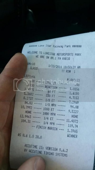

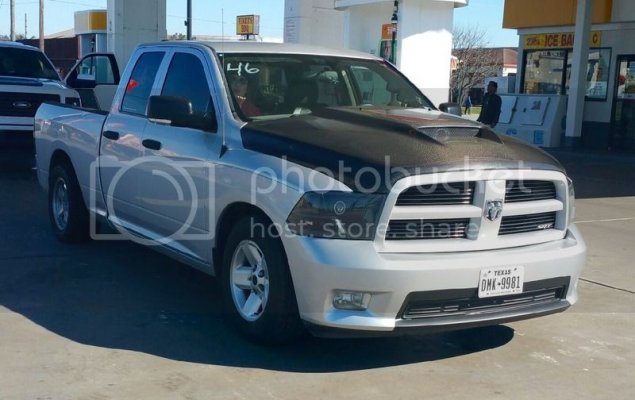

1 of our local quad cab customers made it back out to the track today and put down a 12.94 @ 104.31MPH. He had some traction issues all day, and only cut a 1.91 60' on this pass. I have high hopes that he will be in the high 12.6 to low 12.7 range once he gets the tires to grab. His truck info is below...
HEMIFEVER Custom Tune
Ram Air Intake
Moe's Performance 87MM Throttle Body
Modern Muscle Ported Intake Manifold
JBA Longtube Headers
Detroit Trutrac w/ 4.56 Gears
Edge Racing 11" 3400 Stall Tq Converter
ATI 15% Underdrive Pulley
Billet Tech Catch Can
V6 Efan
170* Thermstat
M&H 325/45/17 Drag Radials
