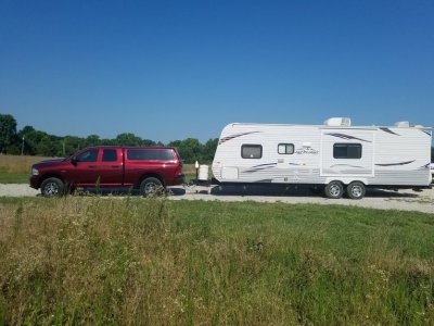

That will work just fine, as long as you watch your numbers. Wife takes kids and dogs and all the luggage with her in her Durango, and I️ pull a 9500# Open Range “Light”. Set up your hitch and make sure the brakes are good.
Now cue the weight police who will yell at you and say you can’t do it and blah blah blah.

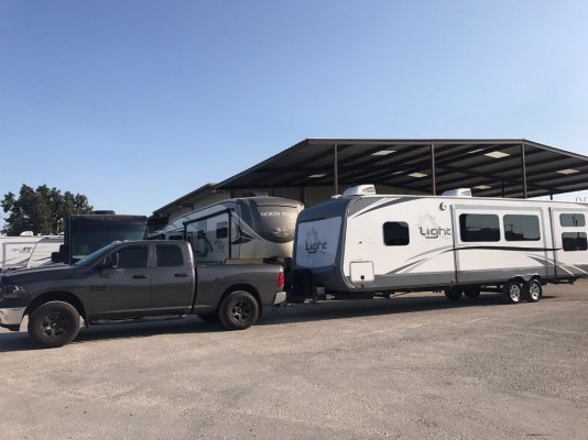

69GWC
Power Wagon
Oct 1, 2015
5,387
6,957
Spring hill, Kansas
2022 Power Wagon
6.4 Hemi, 8sp
What I pull with mine, I had just pulled it put to see where it was setting at hitch height in this photo.
With the wdh you have you should be fine mine pulls this easy even with the 3:21s.
Nice looking setup. I came close to buying an Open Range Lite but, since the nearest dealer is a good ways from me, decided I didn't want the hassle when something was wrong. It an RV that's hand built, something will be wrong.

Thanks that' is helpful. Nice looking setup. My trailer is shorter than that so that helps too. I posted in the previous reply what I am going to do for better storage. This would be to both make it easier for accessing what i need and to help distribute the load better too.
