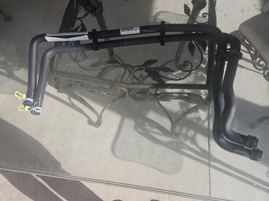

Don't mean to hijack the thread, but what did you do with the transmission heating lines after removing the 3-way valve? As far as I understand connecting the heater hose to the water pump outlet would leave the tranny without any heating.
Maybe it's not that of an issue in FL though. :)
The 3-way valve is still on the truck. I removed the hoses that hook to the 3-way valve and left the transission heater lines in place, I have not cut them off yet. I will likely do that at some point. I do have to do my transmission service and install a PPE pan.
I ordered part # 55056906AH which are heater core hoses for a 5.7 Hemi without a 3-way valve.
Perfect fit from the engine to the heater core.
You can still see the transmission heater lines next to and below the top water pump hose.
Not sure if I will remove the transmission heat exchanger yet or not. I do have @caulk04's bypass to install as well.
My transmission temp still gets up to around 180° eventually. The other day, it was 40 degrees out and when I got to work after driving 26 miles, trans temp was only ~130°.

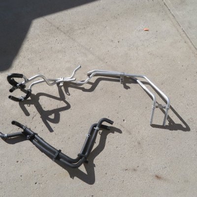

FYI: only the 1500's use coolant to heat the transmission,the cars with the same 8 speed don't heat the transmission with coolant,and neither do the 2500's and up with the 8 speed heat the transmission fluid.
They still have a transmission thermostat,but it's a stand alone thermostat and not attached to the side of the transmission and stuck under the thermal management unit aka: heat exchanger.
These are the lines that can be eliminated if you get rid of the leak prone thermal management unit,which will pump coolant into your transmission if it ever leaks,destroying your tranny in a matter of a couple miles.
Read through this thread on how to eliminate the heat exchanger.

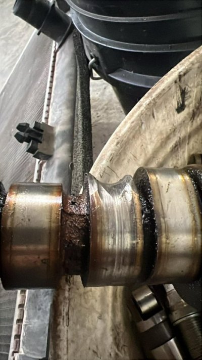

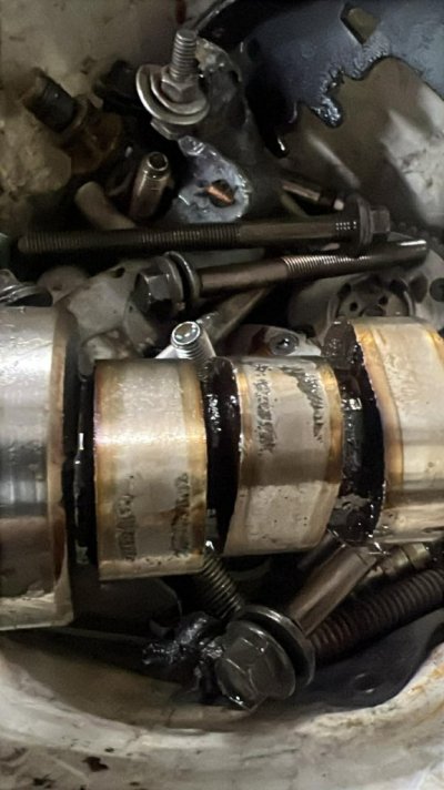

I got mine done, and boy was that camera eating up. Went ahead and did the delete and the oil pump. It's my busy time of the year, so I had a friend's shop do it parts and labor, and the tune was out 3680. Although I am sure I could have done it, the hours were better spent doing some other IT work and paying him to do what he does.
Looks like good ole lifter turned sideways.
I wonder how much metal was on the VVT solenoid.
On what cylinder did the lifter go bad?
