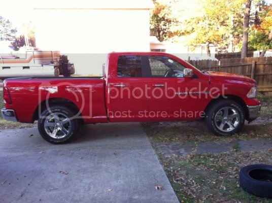

Put the bilstiens in today at their max setting. hope they will settle in a little bit cause it seems like the nose is a little higher than the rear. bought new tires as well, not the exact ones that i wanted, but they will do. 275 65 20 nitto terra graps. i wanted BFGs but for some reason when i was ready to buy them the price jumped on the over 300$. Oh well, these will do until i want new rims and 35s.

that looks great!

I think it looks perfect. Would not change it. Have you got it aligned yet. That may straighten everything out and give you the look. Or if not, you can get that Top Gunz 3/4 inch rear spacer like I did for $39 bucks and then have the look you seek.

thanks for the compliments guys, im going in for an alignment tomorrow. if they dont settle any i think im just gonna do a spacer in the rear. i def dont feel like taking them back out just to drop them a not!

you gotta link to that spacer? and did you put it in yourself?

Here is the exact ones I purchased.
3/4" 09-11 Dodge Ram 1500 4x4 Rear Coil Lift Spacers @Top Gun Customz
They worked perfectly!
I had the people who did my Bilstein kit, do the spacer. They charged me $25 to install those. It took them like 10 minutes. I don't have a spring compressor, and was reading that the ones you get from Autozone and O Reilly don't have what it takes to compress the springs so that is why I hired it out.
Supposedly the back, you can install and not need a spring compressor if you jack up, unhook sway bar and shocks and lower the differential down slow, pull the springs install spacer and springs back and jack up and rehook the shocks.
I will tell you that they come with no instructions.
