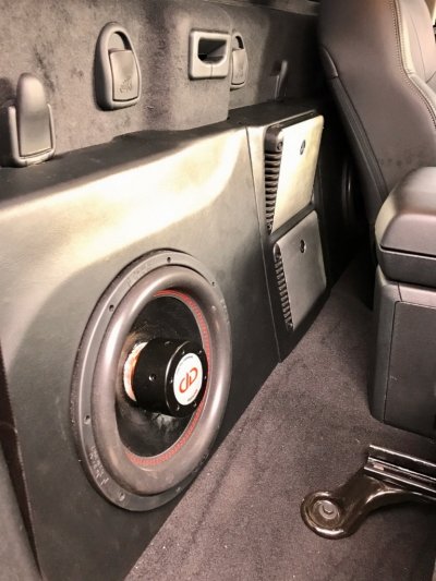

Here's the funny thing the subs sound amazing. It's just the high that sound crappy. b65d895faba451a913164e62fb67d13f.jpg
This is my sub setup
