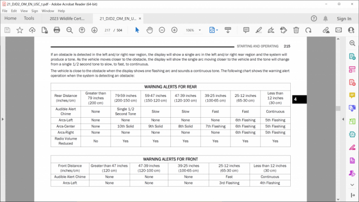

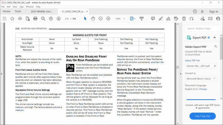

Interesting. I hit a deer with 800 miles on the truck. The only damage was a dent in the front bumper. That was replaced by the body shop. I guess they put one in without sensors. But that was 27,000 miles and 5 years ago. I never noticed.
If it came with front sensors there should be a seperate button to turn off the rear and another to turn off the front, right by the tow haul button.
This is from my HD 2021 manual. Double click to expand picture so it is easier to read.
