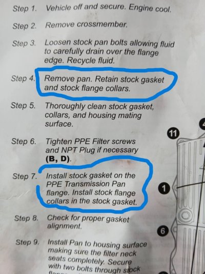

Been binging on threads here regarding PPE pans. I'm sending back the Dorman mopar clone I bought from rockauto and buying the PPE. My question is regarding fluid temps and where I live. I just retired and won't be commuting 100 miles to work on weekdays. Probably will be making mostly short trips now here in New hampshire. I'm wondering if the PPE pan along with the caulk bypass I'm installing will be a disadvantage here. Will transmission temps be too low? I don't tow, just drive around like an old lady now. LOL! Also, those with PPE pan do you order a gasket or reuse the stock mopar one?

PPE pan comes with it's own gasket/oring. I think... Hmmm. Now that I think about it I really don't remember.

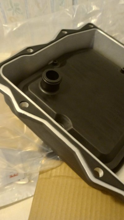

Thanks for the reply. No gasket is not included with the PPE but the filter is.

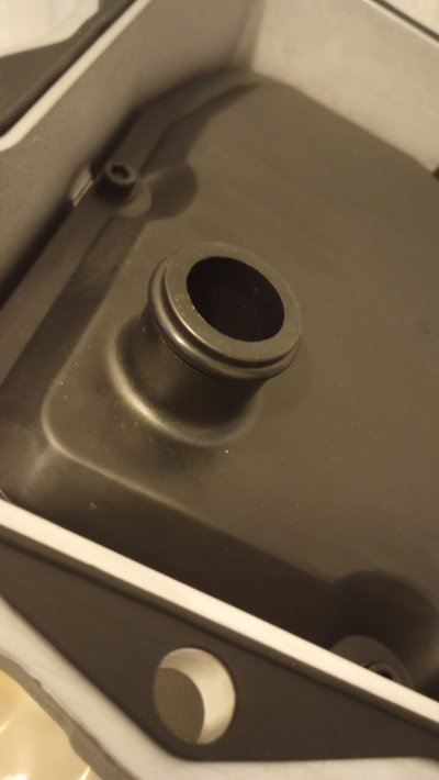

... and you have to transfer the O ring over from your "old filter".

Yep, I was thinking that bypass combined with waiting till weather gets cooler in a couple weeks will help out with the tranny fill. So that new PPE filter doesn't come with a new O-ring? That's cheesy.

I ordered a new MOPAR tranny gasket when I ordered my PPE pan, I'll eventually get around to performing this task ...

Lol, nope ... you gotta use the one off of your old filter ...
