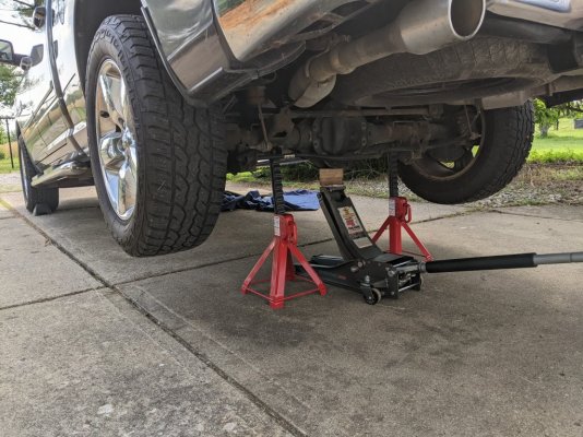

Had to jack mine up 10.5" to get the tranny level, used 6 ton set of stands, made in USA. Used the LifeGuard Fluid 8 from Carid website, had the best pricing and veteran discount. Drained 4qts when cold (not able to pull drain plug without a shaved 10mm right angle because of the exhaust pipe) and installed new Dorman filter, came with new bolts. Torqued T-40 bolts to 89" using the proper sequence. Initial engine off fill was 3 quarts, then started and filled another 2 qts, total of 5 qts. Did the green card procedure and in the temp range, pulled the fill plug and it was dripping out. Took for test drive and everything is working fine. I might check it again one day when I feel like it.
