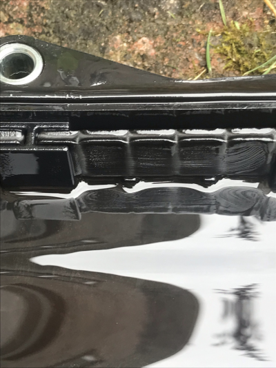

5) Examined the magnets in the pan and found they had little buildup of material after 10 K miles
6) Smelled the D6 tranny fluid and it smelled and looked brand new.

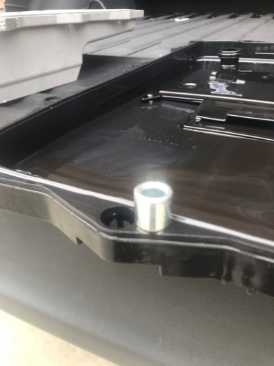

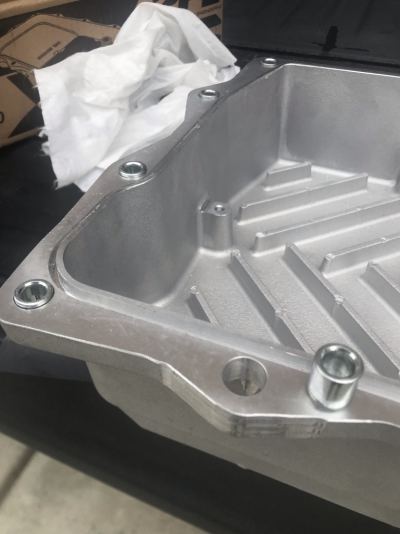

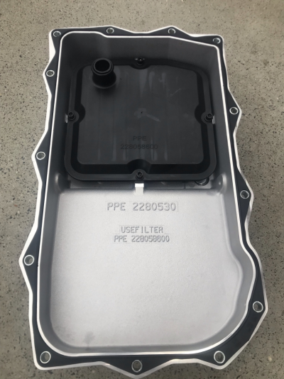

I prepped the PPE pan by taking the filter out that comes with it and set it aside. I then removed the silver metal sleeves/guides from the old plastic pan and installed them in the PPE pan. This took a little doing with a file to allow for a snug fit. I felt the sleeves would keep the pan aligned and aid in keeping the gasket in place around the bolt holes. It seemed to work well as the gasket fit nicely once the pan was cleaned and filter put back in after the sleeves were installed. I used a Mopar OEM gasket. Pic attached with part number.
After installing the gasket I installed the pan under the transmission without much trouble. There was plenty of room between the exhaust crossover and the transmission valve body so it wasn't an issue. I pulled the torque specs and tightening sequence down from this forum and buttoned it up.
