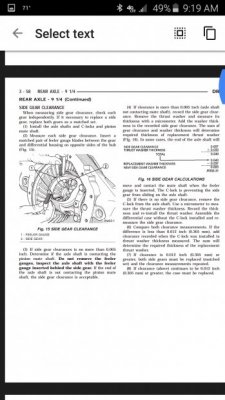

Hope this helps!
The adjusters have to be backed off, possibly only one side will do.
