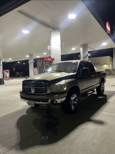

I have been trying to find a 2/4 kit for my ram but I haven’t been able to find one can someone help me out ? I have a quad cab

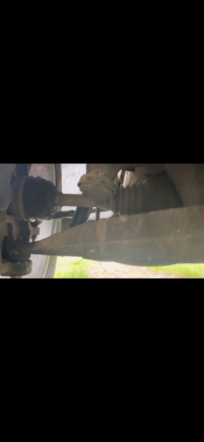

i ended up buying a mcgauthys kit from this website https://switchsuspension.com/dodge-ram-1500-2006-2008-2-4-5-deluxe-drop-kit-mcgaughys-part-44014/
it was saying it would work for a 4wd but when i took it to the mechanic shop the guy ended up saying it wouldnt fit because the spindles would hit my cv axle ruining it. What do you think ?

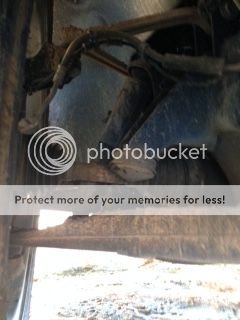

My CV’s clear fine.Those are the same knuckles I have. I was looking on here for a pic I had posted because it’s dark outside. The only one I found has a photobucket watermark across it. But I’ve had no issues in 60k miles on mine. I can take pics after work tomorrow if needed.

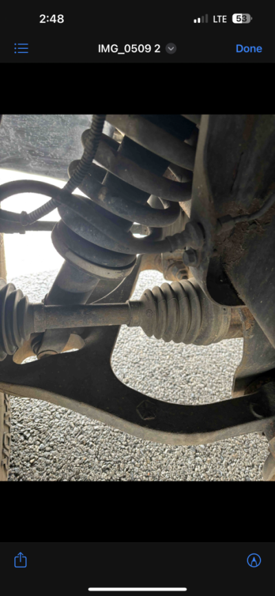

This is a picture of it. There should be no problem installing it on my ram ?

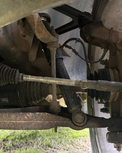

I think you’d be fine. You’ll have the cv shaft a little closer to the bottom of your spring/strut base but that doesn’t move. Mine is a torsion bar setup but the axle is almost horizontal just sitting there.
