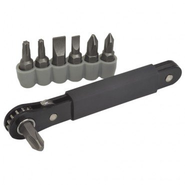

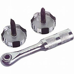

There are no issues with being air tight or bass/vibrations with those little things, so as long as they are not bouncing around they are fine.
I made marks and then made holes with the speaker out so I wouldn't slip and ruin the speaker. Used stubby screw driver to screw 'em in.
It's probably not a bad idea to put some weather stripping or something between the speaker and the plastic, but I didn't...

I have on of these things, too. Comes in handy A LOT!
