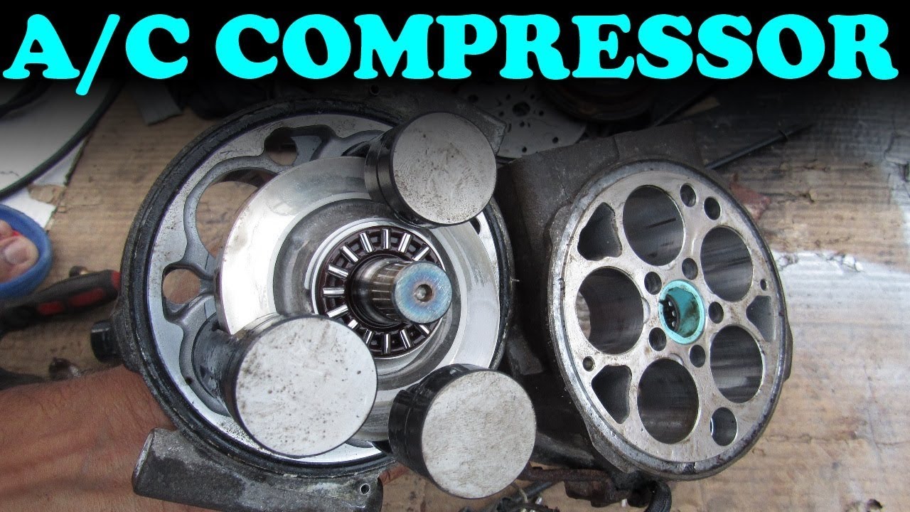

No problem, I can help you with that. Notice the pulley, that is what supplies the lion share of the power to run that item. That is a ram A/C compressor mostly powered by the pulley not going through a relay. That item takes about 2 gallons of fuel to run per tank, good luck converting that to amps, it's complicated. Now if that battery is the original battery, or in the case 2, from 2017 when the batteries were put in a 2018 ram that lives in new mexico, then there is very little chance this issue isn't the battery.
Plus the electrical draw from clutches and blowers, etc. Those do go through relay.
WOW
Man, you are way out in left field.
I’m talking about the electrical requirements of the a/c system, which is what affects the batteries and alternator. The physical aspect of the engine running the compressor doesn’t even factor in. OMG

With respect, he asked me a question on an item before I said I wasn't going to comment, so I respectfully explained the pic.
A= W / V, thus in a 12v system. Example- 100-watt bulb in a 12-volt system will draw 8.3 amps. Now compare that to what it takes to run an AC a compressor versus how much power an alt can generate at idle. Its science.
Oh boy.
As I mentioned earlier, the a/c compressor will have a fuse for the clutch, which is what transfers power from the rotating pulley to the compressor shaft. The clutch in reality draws ~8-10amps, IIRC.
Any modern vehicle with a good battery and alternator can easily handle that at idle.

You've never done troubleshooting on a vehicle's AC and it shows. The compressor is mechanically driven. There is no electric motor inside of it. Take the belt off and apply power to the compressor and you will hear the clutch engage but nothing will ever spin. It's impossible, there's no mechanism inside it to convert electricity to motion.
Then why would the ECM open air valve and send gas at idle to run ac?
Because energy isn't free and drawing power from the crank requires fuel and air no matter if the power is going to the accessories or the driveline.
The electric component is the clutch that engages and disengages the drive. If the AC could run off the alternator and battery it would not stop cooling the vehicle when stop/start cuts the vehicle off at a standstill. The clutch could disengage the drive pulley so the stopped accessory belt wouldn't interfere and your imaginary internal electric motor could power it, but that's not what happens.
Maybe this will help you understand, as he takes one apart and uses his hand to make the compressor run.
The only electrical component is the clutch assembly, which uses an electromagnet. The compressor itself is a *mechanically driven* pump. Zero electricity used or required, same as your water pump, the crank drives it *mechanically*.

If you're not talking about conversion of electricity into motion, then what do you think electricity is doing? There is nothing but mechanical power driving the compressor. Obviously the crank provides enough power or it wouldn't maintain RPMs and would stall.
Show me how electricity from any source can help spin the compressor. Show me a single component that can power the pump. Did you watch the video? You can run power through it until it melts but there's nothing in there that can do anything useful with the electricity.
I think you're also vastly overestimating the power required from the crank. Even at max, AC is costing about 10hp top end on dynos pulls.
