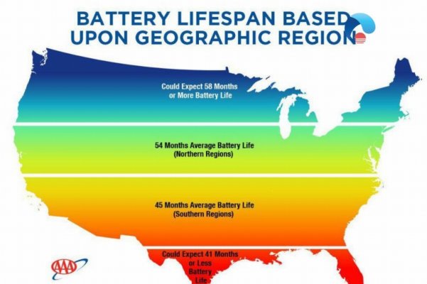

You can drain a car battery in 1/2 hour to 2 hours by leaving headlights on while car off, and that is less the 10 amps to run that item. A truck AC can take up to 200 amps, maybe a little less. The system of gears is designed to have peak amperage from alt at between 1300 and 2000 rpm's by vehicle. Even with two batteries w/o alt it wouldn't take long to drain battery. Now at 800 idle rpm's it is not charging 200 amps to keep up with that draw. Add the possibility of an aging battery in a state with a low average lifespan on a battery life, this makes a lot of sense?
Just ask your Google you see alt generates a range of "An alternator at idle can produce anywhere from 5 to 50 amps, with output depending on the car's electrical load."
So if it was healthy Cummins battery and alt, I can see an hour of AC no issue, but if the battery is even a couple years old in NM it is easy to suspect battery. Average battery life can be less the 4 years there, so the question remains, how old is battery.

OMG! 200 amps? HAHAHA
Check your fuse box. It’ll have a 30-35 amp fuse in the a/c slot.
Not 200a.
BTW, I grew up in southern MM. And I now live in southern AZ. My batteries last 5-6 years at least.
Google isn’t a know-it- all.
