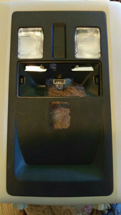

It would be easier to cut into the black plastic part of the bezel. I have an extra one with a switch hole already cut in it if you want something to play around with and not mess up yours...

Where would the switch go exactly? I don't see a lot of room to add anything in the black bezel part
When my sunroof was installed the switch was where you see the white dot in the picture. I moved it between the lights when I added Homelink.
There is a lot of space in that area and the plastic gives you a nice firm mounting surface. I bet you could even find some switches that are angled so when they get mounted there, the switch faces are pointed towards you.

I would remove my outer bezel and keep that and the compass module but you have those parts. Your lights are the factory LEDs it looks like, you can swap those into this or just use these map light fixtures. I'll include some white or red LEDs if you want to use the fixtures in mine, I have lots of extra bulbs.

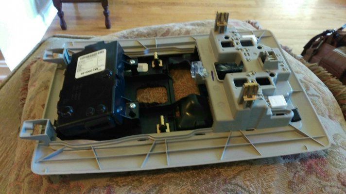

Here is the back of that area. You would have to do some careful trimming to fit more than one switch without compromising the rigidity, but once you installed the switches it would be pretty solid.

I won't use them and with the hole in it I can't really sell it. It's perfect to give away to someone looking to DIY something and give them 1 do-over!
It comes apart very easy, but use plastic auto trim removal tools and not screwdrivers or anything metal.
If you remove the whole bezel, just pull straight down from the cabin side. It's held in with spring clips from the front and the hooks are toward the windshield.
The black inner bezel is the opposite, there are a several plastic clips around the inner bezel and the hooks are on the cabin side in front of the map lights. It also has spring clips in the middle.
It is easier to remove the entire bezel, then separate the inner bezel. It will feel like you're gonna break something when you pull it, bit it'll pop free all at once.
