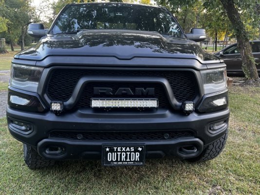

Anyone else have this type or simlar of a light bar switch?

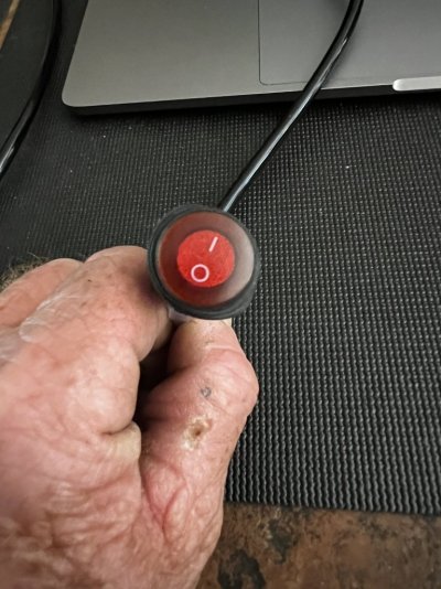

I am about to install two of these switches and am wondering where you mounted yours? Found one place just to the right of the steering column, but that spot is also hidden from view by the steering wheel.

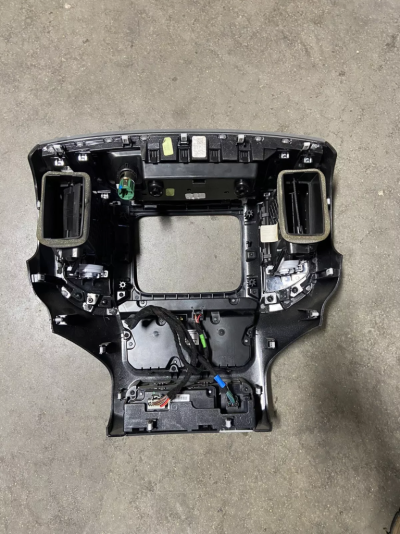

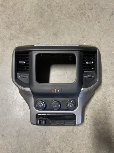

IF ...
You have a Overhead Console ....
Contact someone that has pulled the BEZEL that holds the radio in place
Your Bezel may be a different type
Classic or New Style

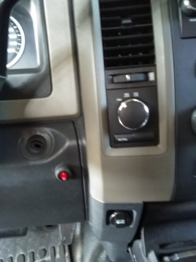

Just hate to cut the dash AND they never put instructions in these damn things so i have no idea the correct diameter for the hole. Seems to be between 3/4 and 7/8 but I have no hole saw that size. If I drill the wrong size I am F'ed. About to abort until i can get another solution.

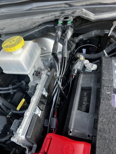

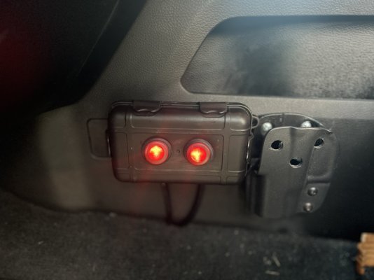

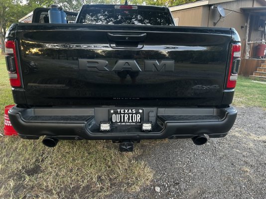

Decided to enlist the help of a knife case I had and mount the switches where I can see them [and also close to where I had them on my 2016 Sport]. Running the back light wiring right now. Just couldn't cut the dash, especially since the light switches would be hidden by the steering wheel.
DeckArtist
DeckArtist
Jan 3, 2019
666
604
Elmo, Tx

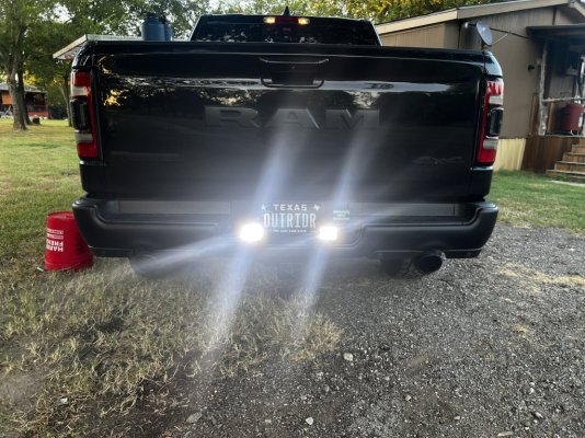

Those who drive with their brights on....BEWARE!

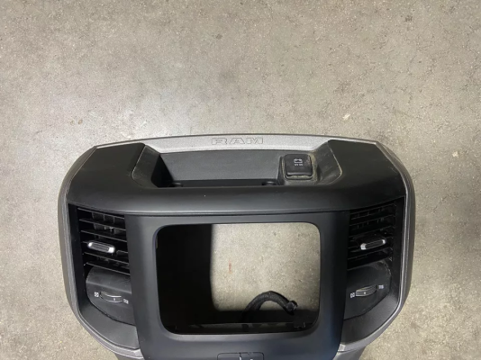

By far the best set up I found was to look at a s 2500 or 3500 which come with one switch panels. They fit in dash below the radio where the Ram plastic emblem is. Thru pop out and the 2509 switch panel pops in. Works with an open fuse spot u see hood. Looks great and one extra bonus is they shut off on their own when you turn truck off. Comes with 4 built in own switches.
