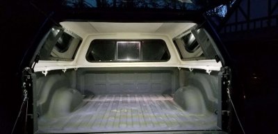

Picked up a cap that didn't have the carpeted headliner wondering if anyone here ever carpeted their own? If so what did you use to hold the carpet on and what type of carpet did you use?
Got a bed rug for the bottom but can't seem to find any kind of like kit you can buy would think someone out there would make pre-cut kits guess not.

Spray epoxy... spray both surfaces and let it tack up before you stick together. Make sure you've done your fitment first as it will never be coming off again. Use a heat gun to help form into and around complex corners

I did pretty much what @sbarron suggested. I also had a small linoleum roller available to press the carpet into the corners and to roll it flat.

X3 I did a similar thing when I lined my ex gfs hsrd top for her jeep. If possible take it off and flip it upside down, gravity will be your friend and enemy. I can't remember what epoxy I used but that **** grabbed like an angry chimp when I stuck them together, so be 10000% sure you're happy with fitment. I went to a marine/boating place and looked at some deck carpet since it's pretty durable stuff.

Take it off to do the roof and save yourself from fighting gravity. Speaker box carpet would work fine or go to an camper/RV place and have them order you a roll spray glue is a must and a roller will be your best friend
