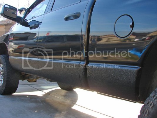

I was even thinking of doing about 2 inches up on the bottom of my doors, and possibly the inner pinch seams to prevent rust in the future. Tired of chrysler pinch seams rotting in the salt belt.

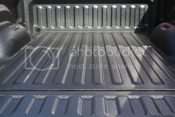

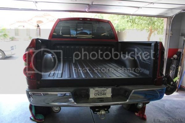

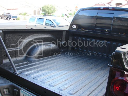

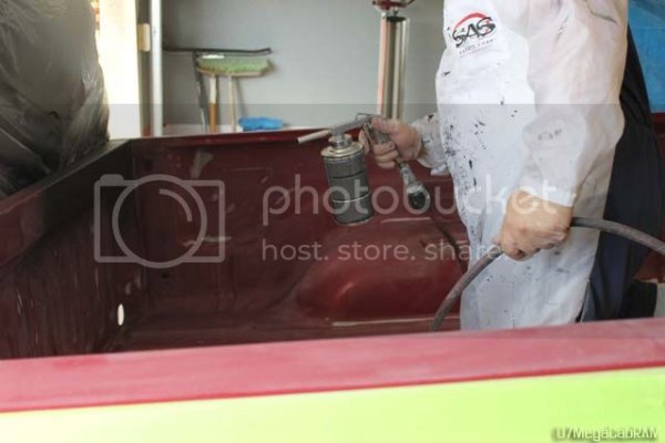

I have done many. 30+
Really easy to do *IF
You have a good compressor
Know how to lay down even amounts of product
It's pretty easy actually. It's one of those things you do a few times and you've become an expert on.
I've used SEM, Raptor, Upol, Custom Coat, you name it..

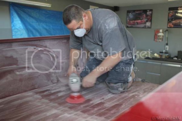

Key, like with everything is prep.
I have a really heavy duty buffer and I purchased a 6" cup brush for it and it sped up the prepping buy 80%.
Clean it with wax and grease remover really really well..
and lay down the foundation.
Once you get the foundation done, you do a light mist coat over the entire thing to get it to look very even with the sheen.
I was doing them for friends, family, co-workers for a while. I had that truck 3 years and used the hell out of the bed. No issues !! Even from the sun here in Arizona.
