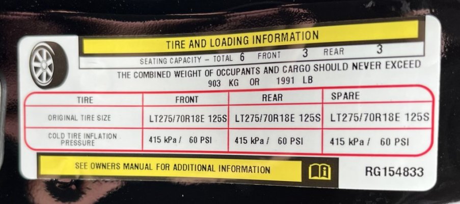

What size are your Transforce tires, and what does your B-pillar say your PSI is supposed to be for them?

Stock LT 275/70R18. B pillar label has Front 60, Rear 65. Ran PSI all the way from 70 to 80 and still had side to side motion that was exaggerated on the road towing. Typically run about 70 psi now based on tire inflation chart when towing.

I'll assume that the 275 are stock on your because of the Crew Cab. Mine are 245/70R17 E, and the B-pillar calls for 75 front and 80 rear all the way up to GAWR. Strangest thing I've seen.

I have the 275/70R18E and mine calls for 60psi front and rear.IMG_0444.jpeg
