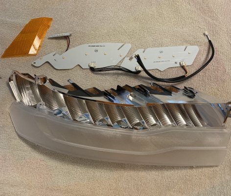

They were just as “fun” to open up as the factory projectors. Seems to be the same type of permaseal. I did 230 for 15 minutes and got them open in one shot.
The chrome projector shrouds are part of the facia mold and are not removable, so I had to tape off the chrome.
The led boards are top mounted to each the turn signal and DRL reflector housings.
I went with the profile pivot sequential turn switchback strips for the bottom. Leaving the top DRL as is, and painting them, that’s it.
I’ll post the pics in a little bit here.

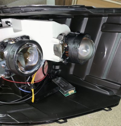

Got mine installed today. I couldn't get the passenger side locking tab to lock but not worried about it now. Driver went smoother. Install the Hikari led's.
Also discovered that where the drl wire goes into the headlights there is a rubber seal it's just pushed through. You can push it back through by using the turn signal hole. It's a little bit of a pain but can be done.
For the drl's. I used the drl harness it came with, I happened to have the same connectors they used to connect the harness to the drl module so I made a section to go from that harness to the front end module. My truck was wired from the front end module to the bcm already so I didn't have to make those connections.
BCM C1/A
https://www.mouser.com/ProductDetail/829-13627884-L?r=829-13627884-L
BCM C4/D
https://www.eficonnection.com/home/product/kostal-slk-28-female-sealed-20-18-awg-05-075-mm2-terminal
You'll need (should be the same on 13+ but @Jimmy07 may be able to confirm)
https://nexelec.com/YAZAKI-7116410202/
And
https://www.mouser.com/ProductDetail/Aptiv-formerly-Delphi/15366021?qs=xyz6lfZ1ktLi71fiB65FCg== (these worked the best for me with 18ga wire)
These are the connectors they used
https://www.amazon.com/dp/B014IU2EE2/ref=cm_sw_r_cp_api_i_85nQCbVYMEM0P
Use http://connectors.dcctools.com/home.htm#year_platform to verify where the dedicated drl pin locations are for your year.
After everything is wired and you already have drl's enabled (if not go to page 1 in alphaobd look for my name and click the Google drive link) go to body Computer 2013-17 > car configuration > CBC I/O Left/Right Dedicated DRL Lamp/Headlamp Leveling output >Select YES for both> CBC Features - DRL Lamp Location > Select Dedicated and you are all set.
Only grabbed one pic for now
