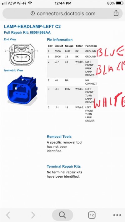

Give me a few minutes to find what's what but if you can (it should be the same plug for low/high as it is for turn/park) take the "extension" off of the headlight feed on the headlights (blue/black /white wires) disconnect the socket for the park/turn bulb and see if that extension will work in between the socket and the truck's wiring. If it works then it'll be better taping into that then the factory wiring

If the extension off of the headlight fits in between the socket and the truck's harness
You'd add a resistor to park feed and the turn feed on the extension harness then the other end of the resistor to a ground
This is how they should line up

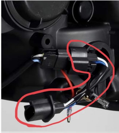

7CB20D4E-EE6D-40C6-A4C8-ADD64E6D067E.jpeg Does it matter if I put the resistors before or after the connector?

View attachment 162194 Does it matter if I put the resistors before or after the connector?
So you want to disconnect that harness from the headlight and move it to the turn/park harness by removing the socket from the truck's harness. place the extension harness you just removed and connect the socket to one end and the other to the truck's harness. That way your adding the resistors to the extension harness and not touching your factory harness
Take that extension harness that you are holding in your left hand and unplug it where you have the red circle. Then plug it into the back of the bulb socket connector that you took off of your quad lights (the connector that you “screwed” into the hole on the new headlights. Tap that extension harness just like 1500ram12 posted for you.

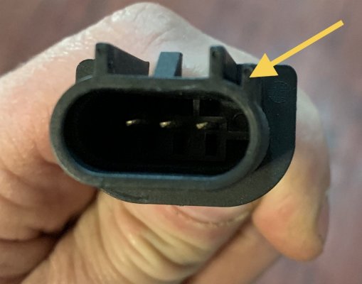

I do have a question before you do all of this with that extension harness. @TatertotScott mentioned above that it won’t plug into the truck harness. If it’s like the one I received, it won’t fit either. Does the end you’re holding in your left hand look like this with the raised ridge where the yellow arrow is pointing?- dhgdLxP.jpg
